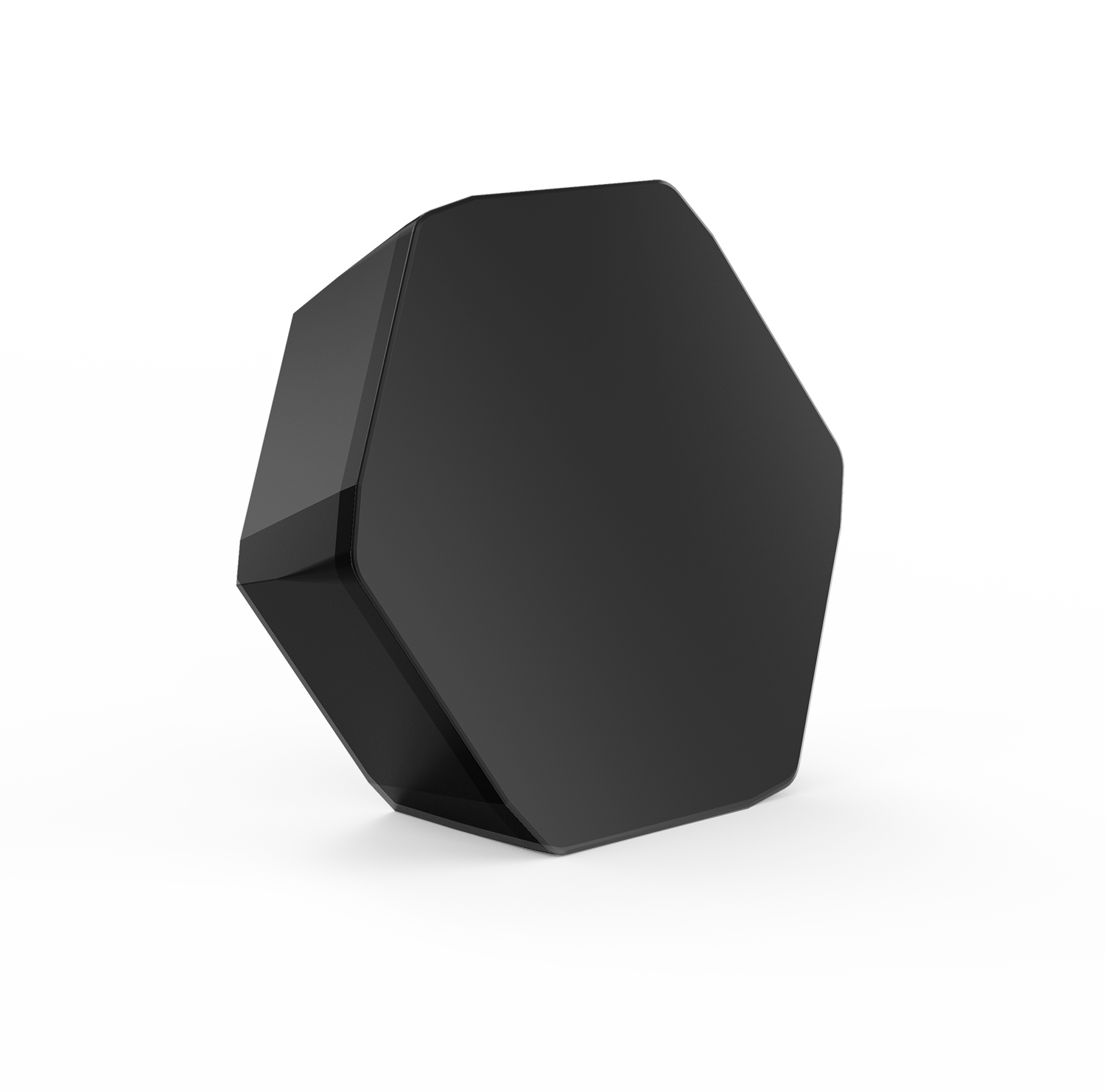

KCFM 45 provides high precision pocket seats with a run-out of two microns, exceeding highest surface requirements.
The super-positive geometries of semi-finishing and wiper inserts provide low cutting forces to manage vibrations, especially on thin-walled cast iron components, covering dry and wet machining conditions.
Ceramic and PcBN grades available. Allowing for higher speeds and thus higher productivity. Leading to lower cost per part.
  • Fixed pockets for semi-finishing inserts
  • Adjustable pockets for cartridges with wiper inserts, and for cartridges with semi-finishing inserts
  • Pocket seat numbering system, reducing setup time
Cutter body features fixed and adjustable insert pockets, providing two options:
  1. Load all pockets with semi finishing inserts when surface requirements are lower. For the adjustable pockets, cartridges for semi finishing inserts are available.
  2. For highest surface requirements, load adjustable pockets with wiper inserts by using the wiper insert cartridge.
Configuration of Semi-Finishing & Wiper Inserts
